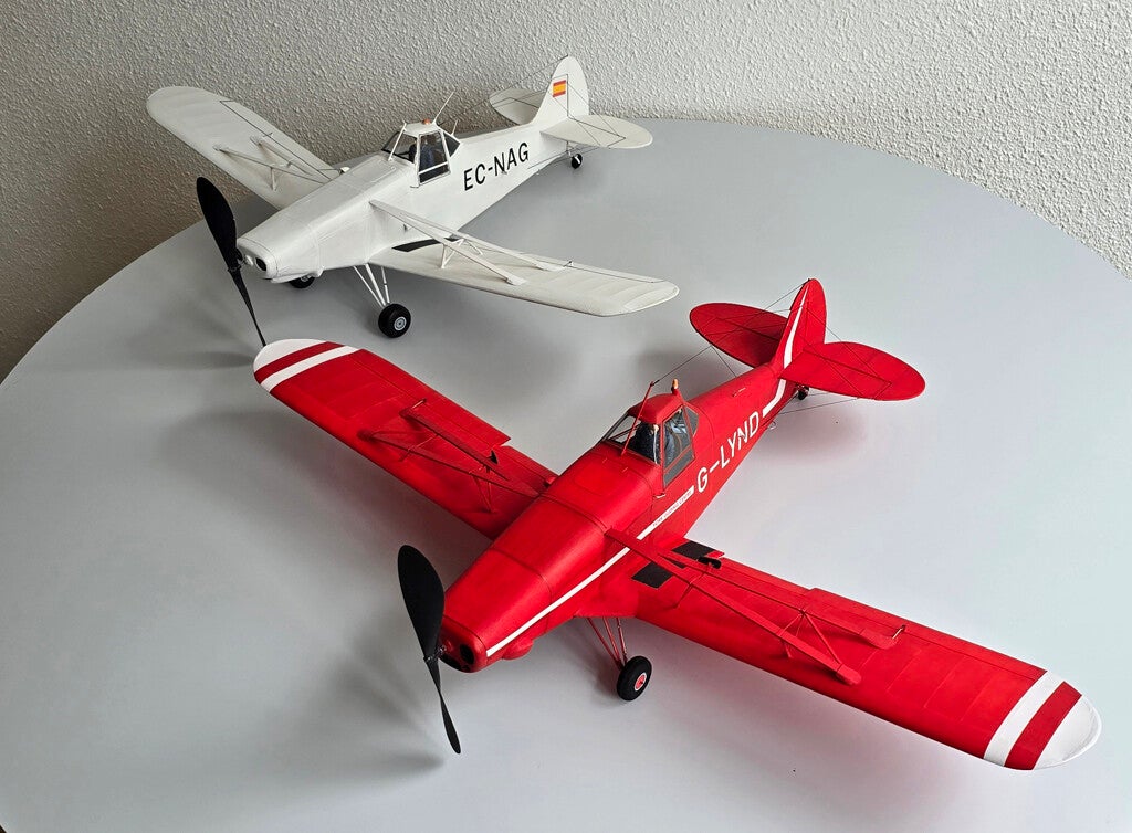

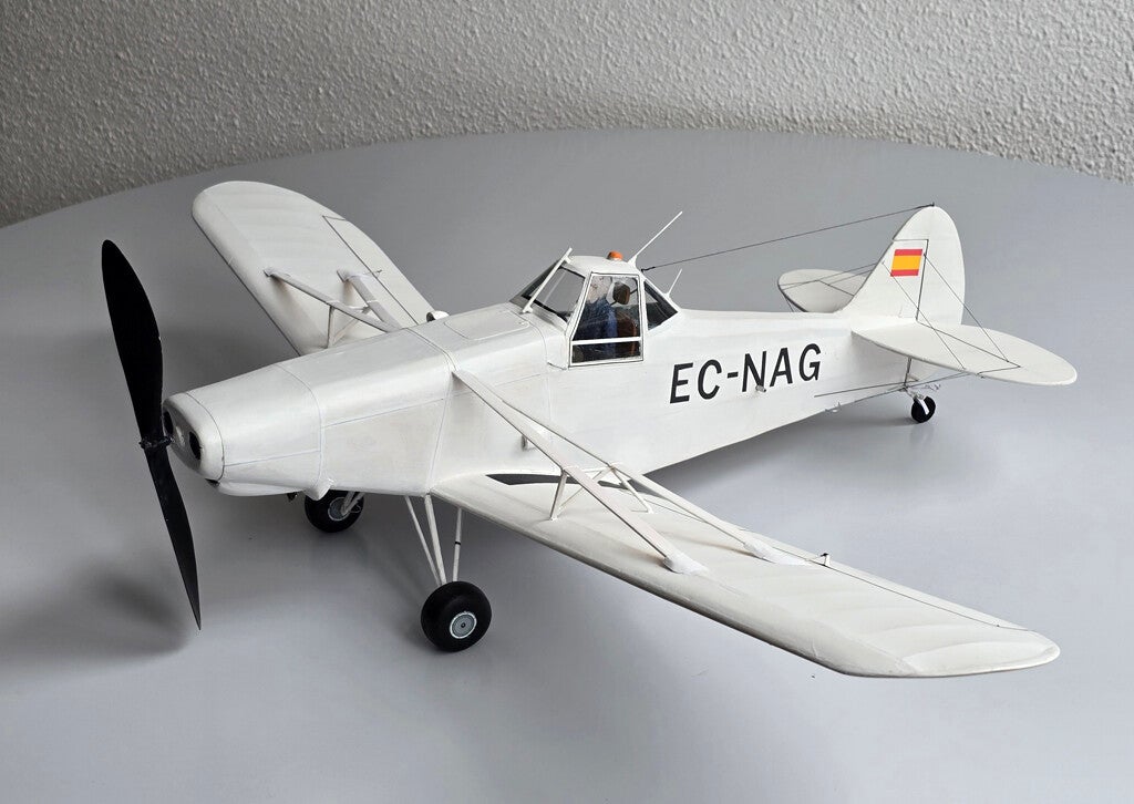

In the meantime, I have managed to do some building:

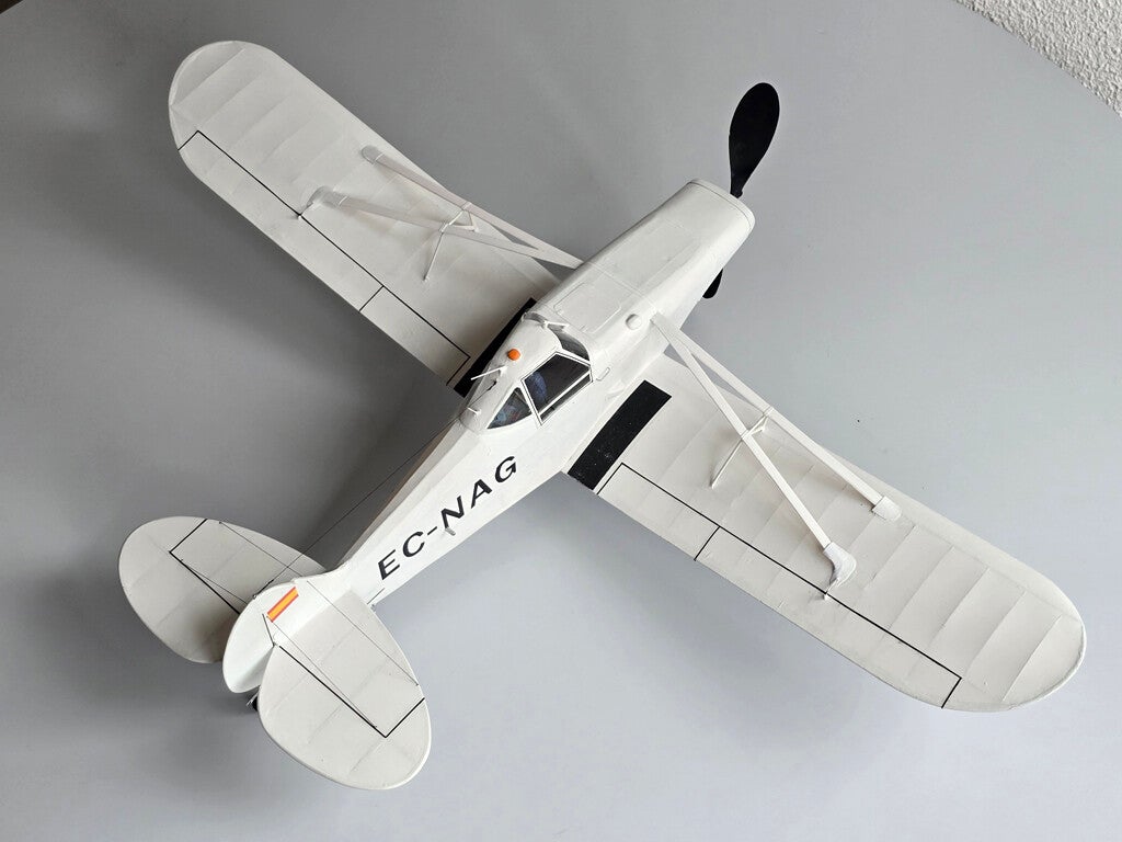

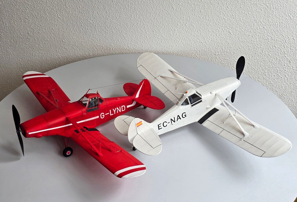

The Spanish white Piper PA-25-150 Pawnee is finished!

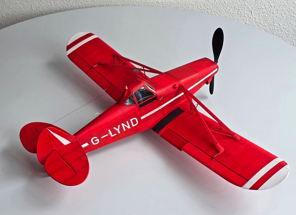

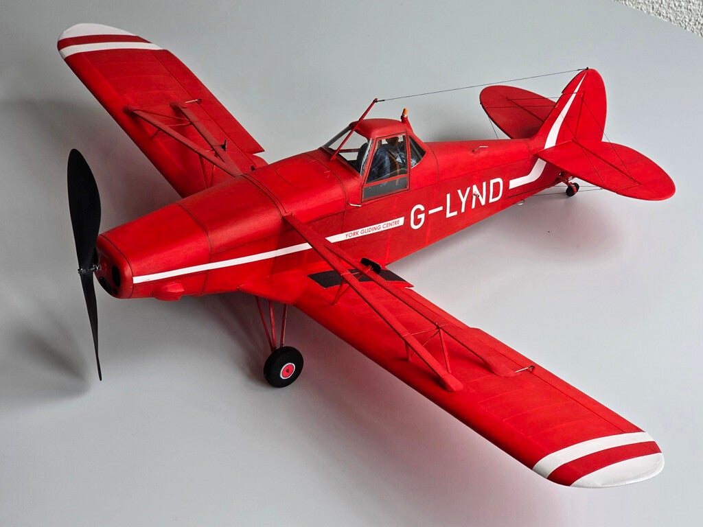

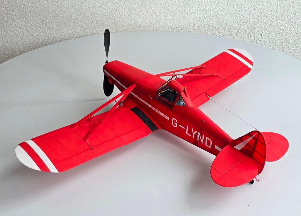

I also built another Pawnee in a different configuration: a British red Piper PA-25-235 Pawnee:
Both are glider tugs, rather than agricultural versions.
The white 150 flies well; the red 235 weighs 2.5 grams more, so I'm quite confident about that one.
When the weather permits, I will make the maiden flight of the red 235.
Both Pawnees are build from the magnificent plans by Richard Crossley
Some build pictures on my website: delooff-aeroplanes
Cheers, Ramses

Piecost
Ramses,
I hope that your health continues to improve. Both models are lovely and I am not sure which I like best.
I see that the red one has seperate control surfaces. That seems a small weight penalty for the additional complexity. Are there other differences?
You seem to have a little flap deflection. What is the thinking behind that?
ramses
Quote from: Spiros on Oct 19, 2026, 11:35 AMExcellent work, as always!!!!
Thanks Spiros!!
Quote from: Piecost on Oct 19, 2026, 12:11 PMI hope that your health continues to improve. Both models are lovely and I am not sure which I like best.
Thanks Piecost!
Quote from: Piecost on Oct 19, 2026, 12:11 PMI see that the red one has seperate control surfaces. That seems a small weight penalty for the additional complexity.
Indeed, but the difference is very little, the Red Pawnee weighs just 2,5 grams more than the white one!
Quote from: Piecost on Oct 19, 2026, 12:11 PMAre there other differences?

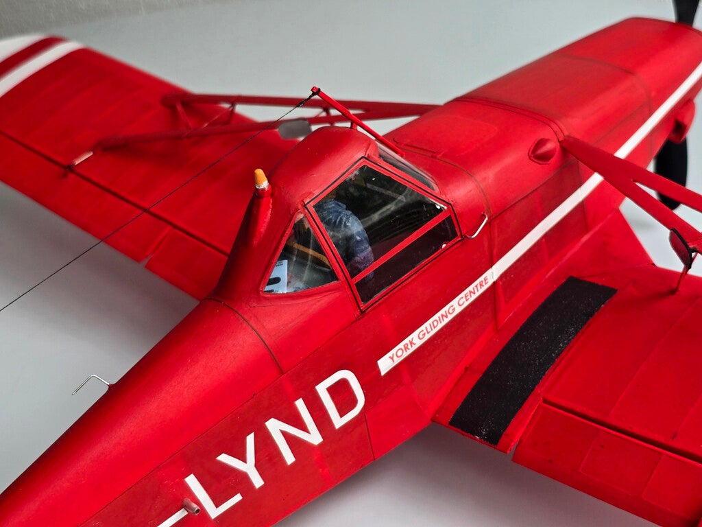

Yes, quite some! The red 235 has a longer and deeper cowl, different exhaust, different wing roots, slightly higher canopy, balsa covered turtleback and different jury struts.
Quote from: Piecost on Oct 19, 2026, 12:11 PMYou seem to have a little flap deflection. What is the thinking behind that?
I hope that the little flap deflection will give a little more lift and will slow the Pawnee a little down in flight. If it doesn`t work, i can set the flaps back to neutral (litho plate hinged).
